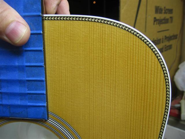

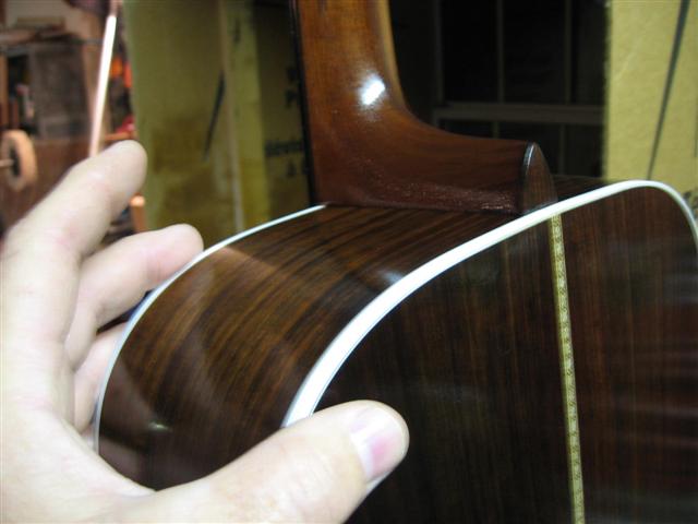

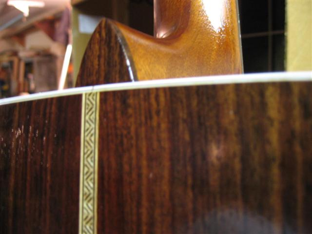

This is a guitar I started in 1999. I strung it up and never put the finish on, until today. This guitar is a gift for a gifted worship leader. She is just learning guitar, plays a mean keyboard and sings like an angel.

There is also a great opportunity to test the effects of finish, please let us know if the guitar sounds any different after she's cured and buffed. If so, what differences are you hearing?

This guitar has a full woody sound, and it would be a shame to lose that quality. I plan on a super thin finish Lance. I french polished in two coats of Zinssers for pore fill. Got a lot but not all the pores.
Then I'll drop fill the lacquer and sand back. It has about four coats and I'll lose about half that on this first sanding, knocking down the spruce fibers, the rosewood is already pretty nice due to the pumice job.
I still don't like the way fp leaves nasties on the purflings and marquetry, so I'm destined to try clear epoxy fill again. My first attempt on number five went badly, but turned out eventually.

Bruce, I'm just curious how you are going to go about the buffing process with the neck attached and the bridge glued on? Reason I ask is, I have a dred on the bench right now that I had to do a little repair on bridge area and it will need to be lacquered again. I am still puzzling out how I am going to get a good buff job around that bridge.

Bruce, you have to give Z-poxy a try, and the trick is to remove every bit of you can when wet.
Lay it out, Squiggie it off, hit with some 320, repeat until all pours are filled, you can see this by holding the body at an angle in the light, it should look glassy. Usualy takes me 3 apps.
Now that your pours are filled and you have burned through in many places (you will and should), take your zpoxy and dilute it 50/50 with DA.
Use a clean cotton cloth, such as an old tee shirt, wet then wipe in deliberate long strokes from the top of the guitar to the bottom, try to over lap your rows, but just enough to not miss any area. After it dries, a quick swipe with 400 should be all you need, and your ready for finish.
Not trying to sound like a know it all, Lord knows im not, but I had a heck of a time with epoxy filler and experienced the same problems I remember you talking about, that was until Don Williams gave me a quick lesson on how to do it and not over do it.

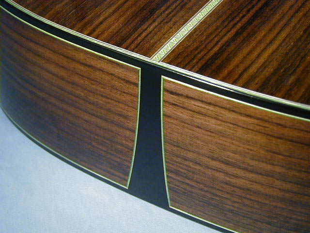

Hey Bruce - is that a GREEN zig-zag backstrip?? Where'd ya get that?

Dave, I have a big ol' buffer and then I'll probably knock the shine off the bridge with a little sanding. Dumb way to do it for sure. IF I learn any tricks I'll let you know.
Lance, thanks for the zpoxy primer, gee, epoxy just seems like a foreign material to fine woodworking? But it must be good for MichaelP to give up the FP fill for it. I'll try it again, soon.

[QUOTE=Pete Licis] Hey Bruce - is that a GREEN zig-zag backstrip?? Where'd ya get that?[/QUOTE]
Green, hmmm it's black and white on my set! It's just the plain old d28 zig from Martin or LMI or INt'l violin, one of 'em. Green would look cool. I guess you could just dye the whole thing and the white would turn, wouldn't it. Kind of a St. Patrick's day idea. Might work, just might work.
PostPosted: Wed Apr 05, 2006 6:48 am
Posts: 183
[QUOTE=Bruce Dickey]Green, hmmm it's black and white on my set! It's just the plain old d28 zig from Martin or LMI or INt'l violin, one of 'em.
Well then, I must be insane. Or my monitor needs calibration. Everything in the photos looks normal, but the zig-zag looks green! I used green in my scheme, but I had to make the zig-zag myself from veneers (shown below).
Pete Licis38812.6591550926
